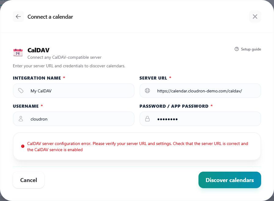

    I have tried to connect Tymeslot with a Cloudron Calendar app via CalDav.
    Unless I have missed something, I do not seem to be able to make this work at the moment.
    Taken from the Cloudron demo server:
    • From Cloudron calendar app:
    • From Tymeslot:
    Not sure if this is a user (me), Tymeslot or Cloudron calendar issue
    Should I be using specific settings to connect Tymeslot to Cloudron calendar?

        I have now installed the calendar app and tried it myself. Can you try the server URL without the additional /caldav? This should work.
        In the meantime, I'll check how I can make the initial URL work, this will be fixed next week.

          If memory serves, I had already tried without the /caldav without much success but I will give it another go.
          Also, I have seen that there has already been an update (v1.12) possibly addressing this("Find CalDAV calendars on servers that answer under a subpath"). So thanks again.

            All I can say is - it worked for me without "caldav", and the last update should have fixed that, so please try again. Happy to look into this again if needed.
