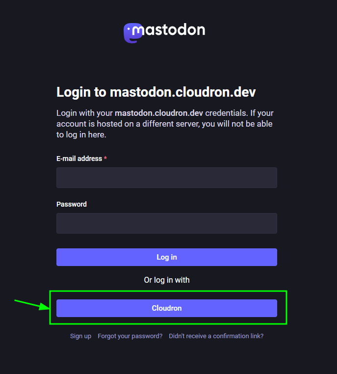

        Hello @yossi6206
        I have just installed the latest version of the Cloudron Mastodon app and while installation I chose the option Allow all users from this Cloudron.

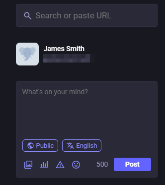

        After the app was running I was able to log in with my Cloudron account with no issues:
        When choosing Allow all users from this Cloudron:
