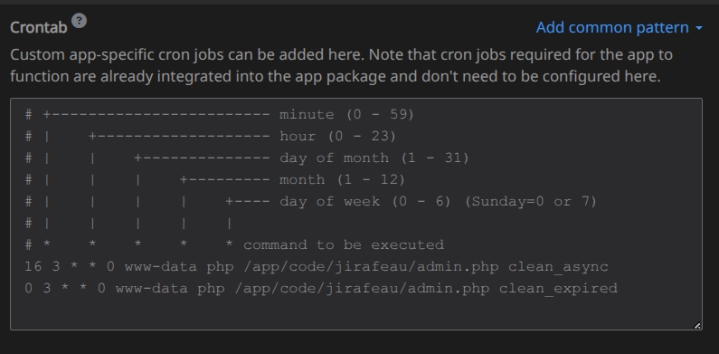

    I wanted to make sure that this file path was correct for Jirafeau. See the screenshot below for the crontab item I have added per the documentation here: https://gitlab.com/jirafeau/Jirafeau#how-can-i-automatize-the-cleaning-of-old-expired-files. Does this look correct (file path)?

      Hello @visamp
      The @jirafeau app should run these jobs automatically.
      The app includes https://git.cloudron.io/packages/jirafeau-app/-/blob/master/cron.sh
      #!/bin/bash
      set -eu
      cd /app/code
      echo "=> Run cron tasks"
      /usr/local/bin/gosu www-data:www-data php /app/code/admin.php clean_expired
      /usr/local/bin/gosu www-data:www-data php /app/code/admin.php clean_async
      Which is scheduled by the CloudronManifest.json cron.
      source: https://git.cloudron.io/packages/jirafeau-app/-/blob/master/CloudronManifest.json?ref_type=heads#L26-L31
          "scheduler": {
            "housekeeping": {
              "schedule": "12 * * * *",
              "command": "/app/pkg/cron.sh"
      Did this not work?

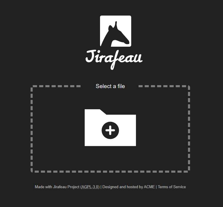

      There is no longer the option to select a time period, so I assume, it worked, and the default is always week.
