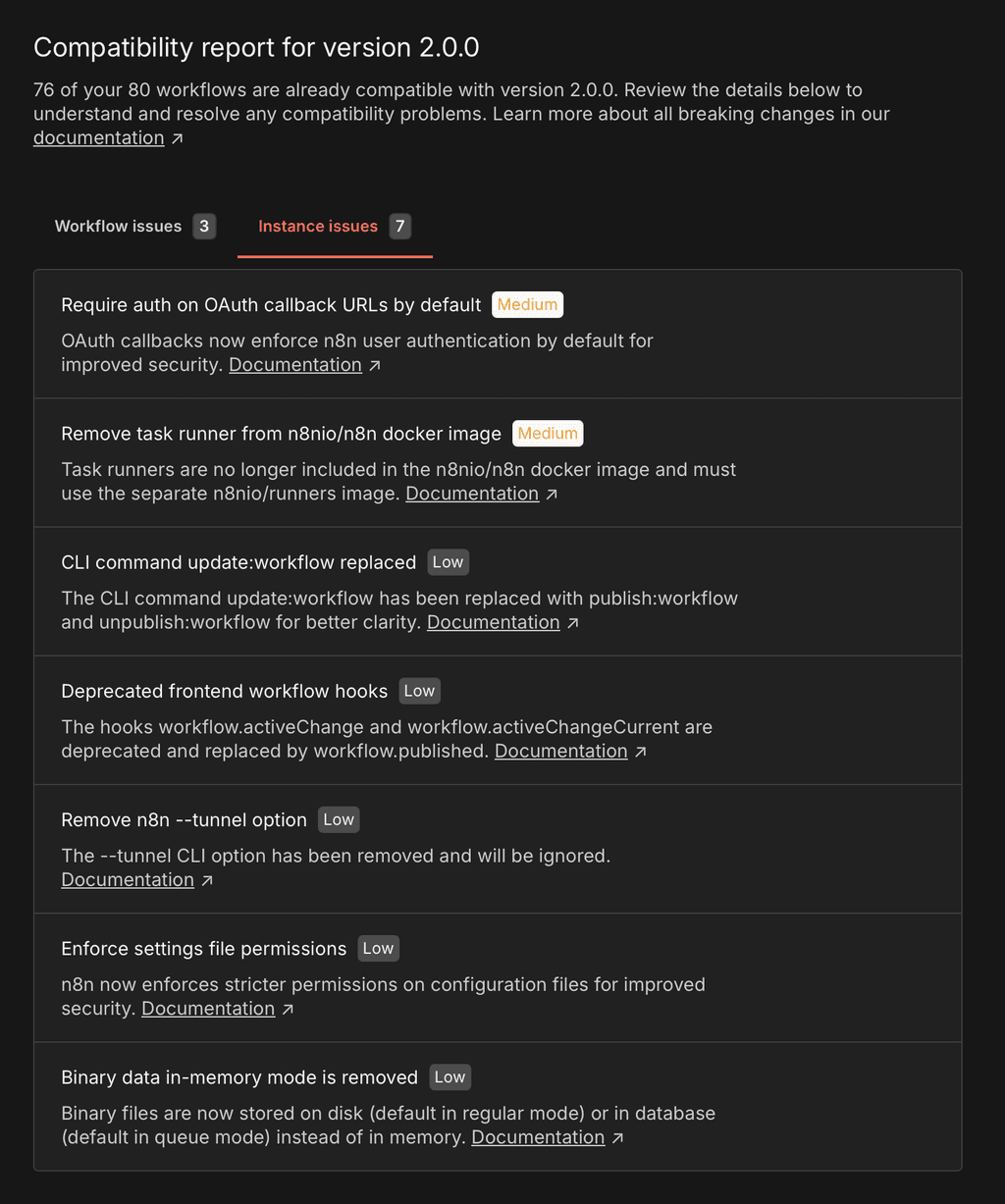

                          I don't think I've changed much if any of our stock cloudron-n8n instances, and here's what our migration report is saying about upgrading to v2.
                          Does anyone else want to share theirs? You can find it under Settings > Migration Report > Instance Tab
