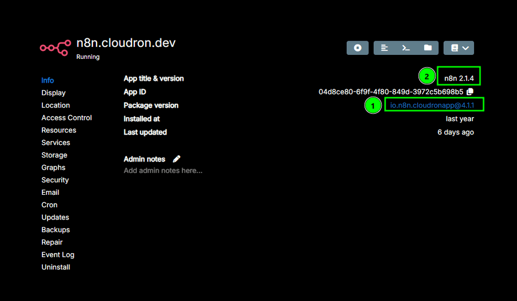

      I have confirmed this is working with the Cloudron N8N package version 4.1.1 (screenshot below number (1)) packaging N8N version 2.1.4 (screenshot below number (2)).
      Running ffpemg -version in the Cloudron app after adding export NODES_EXCLUDE="[]" to /app/data/env.sh and restarting the app.

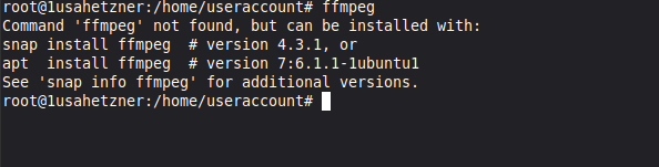

          1. For starters, we checked if FFmpeg is installed on the OS and we get the result that it isn't.
            Screenshot attached

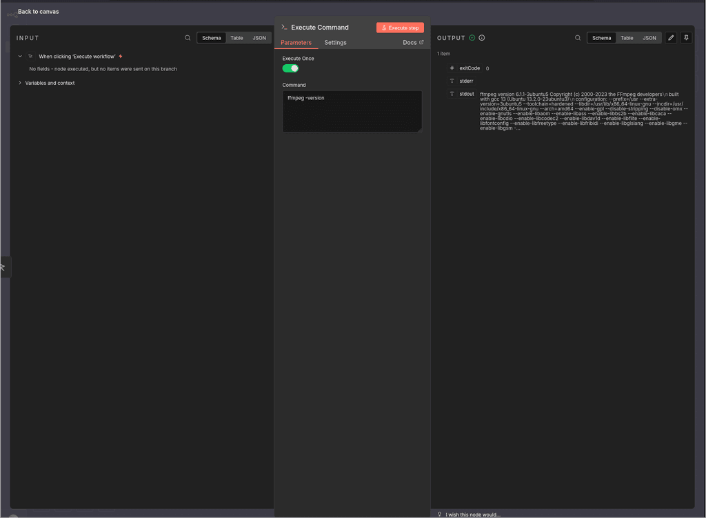

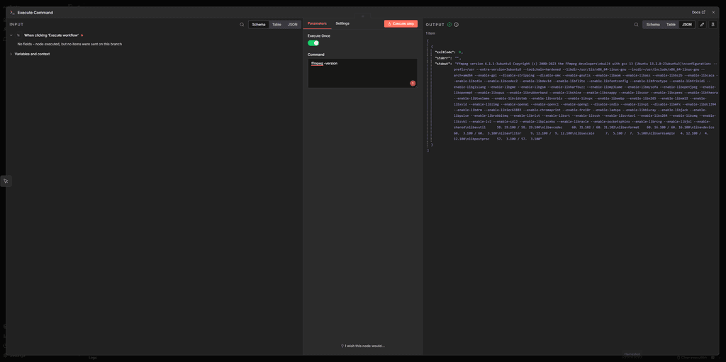

                We performed these steps and it was successful:
                1. Add these lines in env.sh
                  export NODES_EXCLUDE="["ExecuteCommand", "LocalFileTrigger"]"
                2. Restarted N8N
                3. Performed the test using these steps:
                • (+) - Execute command
                • Execute Once: ON
                • Command: ffmpeg -version
                • Test step
                • Check the OUTPUT - ok (screenshot attached)
