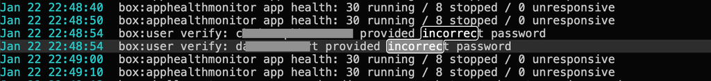

    Security issues?
    I have sever concerns that this might be due to an attack, since I can log several incorrect password attempts on
    /logs.html?id=box such as:
    672bbfdb-c4ba-47ad-86bf-2b0cf3b45dba-Bildschirmfoto 2026-01-22 um 22.52.33.png
    And the frequency of failed attempts seem to be increasing.
