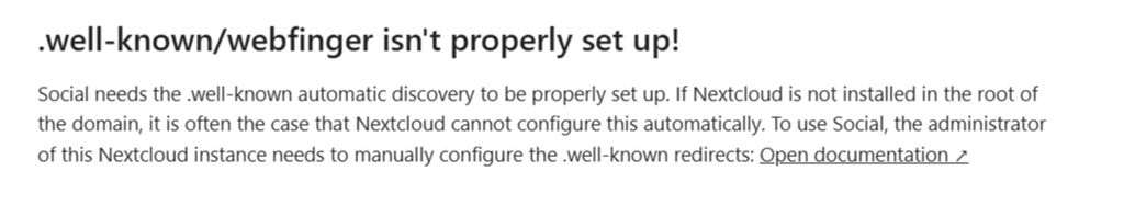

    I get the following error when testing social app.
    I have tried adding to .htaccess file, but when restarting server, the added lines do not remain as seems htaccess file gets reset.
    i have tried adding a .wellknown file and adding the required lines there with no luck. The file and content stays when restarting but not seen by the app.
    App Link: https://github.com/nextcloud/social
    App Store Link: https://apps.nextcloud.com/apps/social
    Has anyone found a fix or workaround?
      The well-known is usually served up by the main domain (example.com) so for a start if your nextcloud is installed on a subdomain, the well-known needs to be configured outside this nextcloud instance. So make sure to have an app installed at example.com so it gets routed to Cloudron. Then you can configure this via https://docs.cloudron.io/domains#well-known-locations
      Though not exactly sure if this nextcloud app would expect the same things as mastodon, but you can try to set the well-known mastodon accordingly, maybe that works. Otherwise we may have to add support for whatever this needs.
