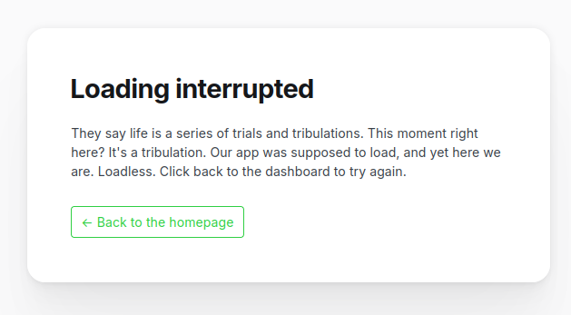

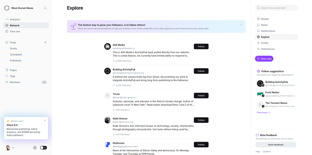

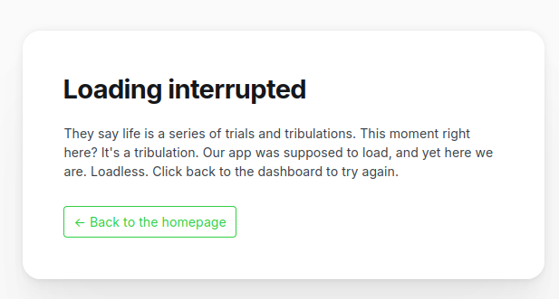

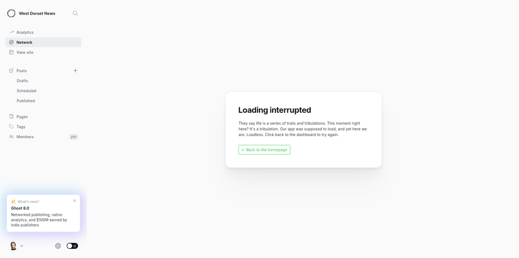

                  @samuk said in Ghost is joining the Fediverse and adding ActivityPub:
                  Has anyone got this working on cloudron yet? I just get an error
                  I get the same thing over on https://uniteddiversity.coop :
                  But on https://nzts.info and https://westdorset.news I see this:

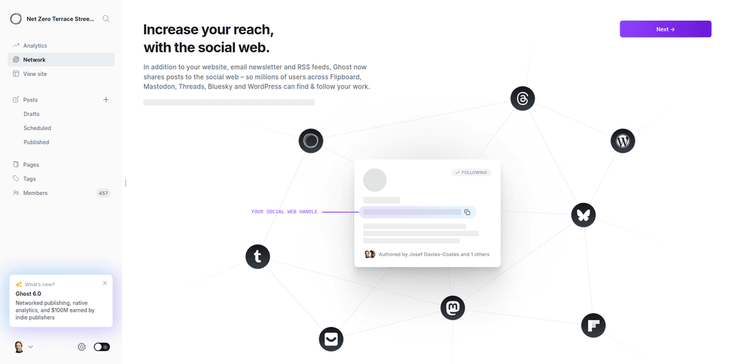

                  And I can click through all of the Next buttons telling me what it's all about and then land here:

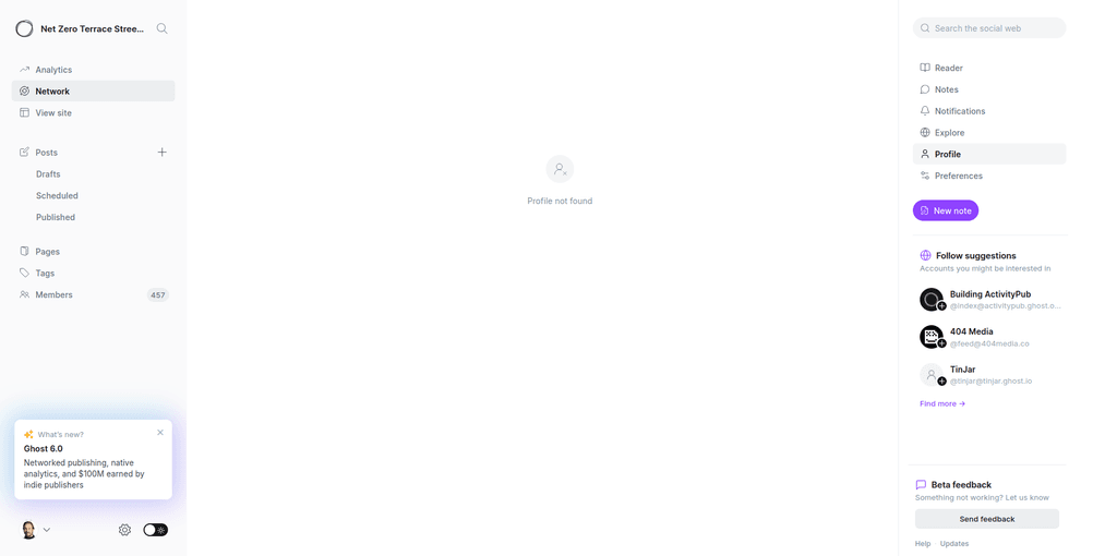

                  But if I search for myself either using https://mastodon.uniteddiversity.coop/@josef or @josef@uniteddiversity.coop it doesn't find me 😞
                  And then after clicking on Profile it says Profile now found:
                  And after clicking on Preferences it just ends up here again:
                  So, was a bit more promising/ hopeful, but ultimately the same 😞
                    So @girish did some investigation on this and it turns out this is implemented in some other project for ghost https://github.com/TryGhost/ActivityPub and with the lack of upstream documentation it is not super clear yet how to deploy this and if this should be within the current ghost app package or as a standalone one. I think he can give a more detailed explanation later though.
