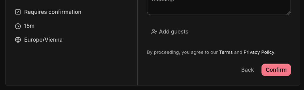

                    @nebulon if you click on an available day and select a timeslot, you get to the detail-view, where the links are at the bottom, next to the confirm button:
                      ah wow, thanks I as on the lookout for some footer or so
                        nice that worked. So next calcom release will include a way to customize those then.
