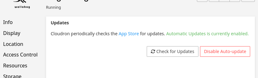

                Hi @nebulon
                Here is the reason the manual update does not work
                Back in the day I did not do what you suggested here https://forum.cloudron.io/post/23720 as I was not aware then of the need to manually update.
                So my wallabag version just stayed at version 2.4.1
                Now, if I try to manually update, I can't, as there is no update button. There is only the "Check for update" button, and when I click on it the circular arrows rotate, but nothing comes of it. And the logs shows nothing.Screenshot 2025-05-04 at 01-35-16 HubbaBubba.png

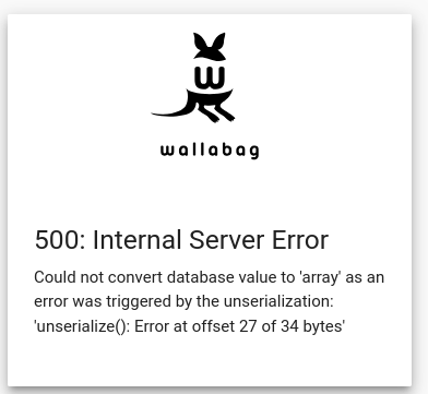

                        Hi @joseph
                        This is the only related entry in the logs when I click on "Export"....and example try to export JSON (It is the same whatever export option I choose):
                        May 05 14:50:12 172.18.0.1 - - [05/May/2025:12:50:10 +0000] "GET /export/unread.json?search_entry%5Bterm%5D= HTTP/1.1" 500 4818 "https://bag.xxxxxxxx.xxxx" "Mozilla/5.0 (X11; Ubuntu; Linux x86_64; rv:137.0) Gecko/20100101 Firefox/137.0"
                        And this error message shows up in wallabag:
                          wrote last edited by joseph
                          I tried to install an old wallabag. Unfortunately this is from 2019 and too old 😞 It fails with "Manifest version must be 2" . If the old wallabag has a CLI, then you should try to export using CLI maybe ? https://github.com/wallabag/docker/issues/213 has the command . Does wallabag have other export formats other than json?
