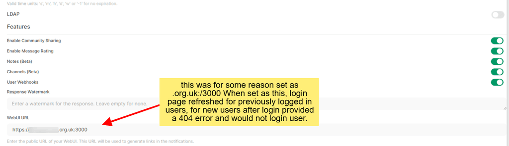

    Issue 2
    • We found that the Setup Page was showing the UI URL with .org.uk:/3000. Not changed by us.
    • We changed it to org.uk:3000, and now the error page after login shows Site can not be reached, and it took too long to respond.
    • I am unable to enter or use the application as expected via Cloudron user accounts.

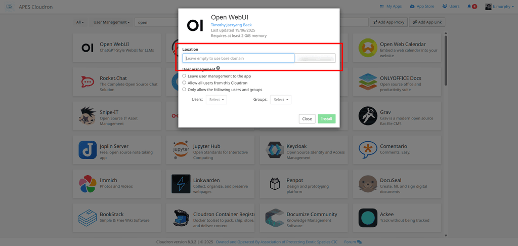

                  1. If the field is meant to be blank. Why are fresh installs completing the field with the URL set at install via Cloudron?
                  2. Also, if that being that it is automatically being filled at the time of install, why is it allowing cloudron logins?

                      When you install a fresh install of Open WebUI it automatically fills .WEBUI.URL with what is entered here in the screenshot. Bearing in mind, I selected to allow all users from the cloudron option.
                      Now if having .WEBUI.URL filled with the URL of your install stops Cloudron login from working. Why is it being auto-filled with the Open WebUI URL when selecting Allow all users from the cloudron?
                      @james said in Issues with Cloudron Login Integration for Open WebUI:
                      You have to put nothing in there. (I did not put that there; you insinuated I had. The URL there was the URL installed by Cloudron at the time of install.)
                      Leave the field alone. Don't type anything in there by hand. (I did not change or type anything in manually. This error with cloudron login started maybe a week or two ago. 2-3 months after initial setup.)
                      Restart the app, this should solve the issue. (Thanks, removing and leaving blank worked, users can now login again with login with cloudron)
                      Since removing the URL set in .WEBUI.IRL in the UI, my users can now log in to Open WebUI with cloudron login.
