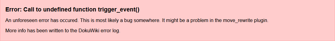

    When I access the pages that had translocated those sections, I get the following:
    The error logs say:
    Jun 24 08:08:50 [Tue Jun 24 15:08:50.038073 2025] [php:warn] [pid 1920] [client 172.18.0.1:48980] PHP Warning: Undefined array key "userinfo" in /app/data/plugins/overlay/action.php on line 82
    Jun 24 08:08:50 - - - [24/Jun/2025:15:08:50 +0000] "GET / HTTP/1.1" 200 4842 "-" "Mozilla (CloudronHealth)"
    Jun 24 08:09:00 [Tue Jun 24 15:09:00.056130 2025] [php:warn] [pid 1921] [client 172.18.0.1:43700] PHP Warning: Undefined array key "userinfo" in /app/data/plugins/overlay/action.php on line 82
    Jun 24 08:09:00 - - - [24/Jun/2025:15:09:00 +0000] "GET / HTTP/1.1" 200 4842 "-" "Mozilla (CloudronHealth)"
    Jun 24 08:09:10 [Tue Jun 24 15:09:10.040656 2025] [php:warn] [pid 1920] [client 172.18.0.1:44088] PHP Warning: Undefined array key "userinfo" in /app/data/plugins/overlay/action.php on line 82
    Jun 24 08:09:10 - - - [24/Jun/2025:15:09:10 +0000] "GET / HTTP/1.1" 200 4842 "-" "Mozilla (CloudronHealth)"
    Is there any way to re-show this data? Thank you.
      This needs to be reported upstream at DokuWiki => https://github.com/dokuwiki/dokuwiki/issues
      Also, the error message states "More info has been written to the DokuWiki error log."
      This might have more details.
      Maybe, as a hotfix, you can re-create that user with the same username and details so DokuWiki get a filled userinfo array again?
