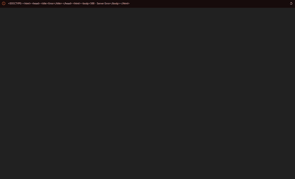

    Hi. Since Packaged v1.17.1 onwards was published I have had a few servers that run Traccar/Cloudron have the following issue;
    "<!DOCTYPE><html><head><title>Error</title></head><html><body>500 - Server Error</body></html>"
    It's not clear from the logs where the issue is - It's resulting in not being able to log in at all unless the OpenID config is removed fully.

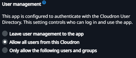

      What type of setup did you chose at installation?

        @james It would be "Leave user management to the app"

          Since you are stating you have installed the app with "Leave user management to the app" and also state the issue gets resolved by removing the OpenID config. Which should not be present when you have chosen "Leave user management to the app".
