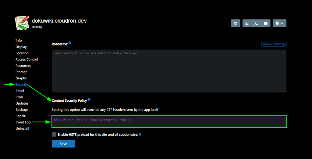

      Hello @TheMoodBoardz
      CORS can be set in the app setting.
      T 1 Reply Last reply

        @james
        Thank you for your suggestion regarding the Content Security Policy (CSP) setting in the application.
        I've investigated that configuration, but it appears the issue stems from a different, though related, server policy: CORS. I believe there may be some confusion between the two, as they have distinct functions. Here’s a quick summary:
        CORS (Cross-Origin Resource Sharing): This is the server giving permission to another website to make API calls to it. The server needs to send an Access-Control-Allow-Origin header to grant this permission, which is what the error messages indicate is missing.
        CSP (Content Security Policy): This is the server telling the browser what resources its own pages are allowed to load. This protects the Fider application itself but doesn't grant API access to other sites.
        Even with the CSP configured, the browser is still blocking the API calls because the required CORS headers are not being sent by the server.
