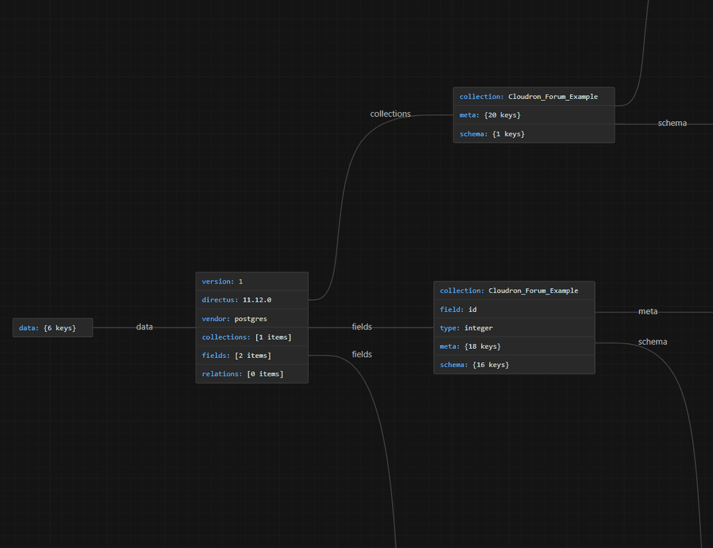

          for better understanding:
          {"data":{INSIDE_HERE_IS_THE_DATA_YOU_WANT}}
          If you put the whole JSON Object inside a visualizer like e.g. https://jsoncrack.com/editor the visual might help.
          You can also append yq to the CURL request so you get the data directly.
          I also added --prettyPrint and --output-format=json for bedder readability here in the forum.
          Note: yq can work with yaml and json and with certain parameters, like --prettyPrint the default output is yaml, so you need to define --output-format=json.
