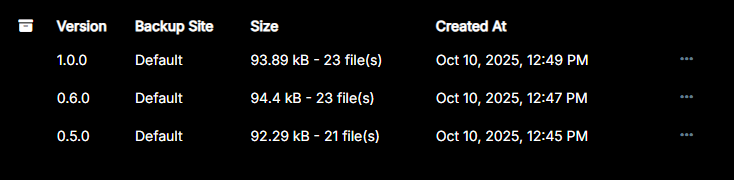

    I've just installed LibreChat Version 0.5.0 and used the Cloudron login.
    Added an OpenAI API Token, restarted the app, made 3x Chats.
    Now I've updated to app to version 0.6.0 and 1.0.0.
    My chats are still present.

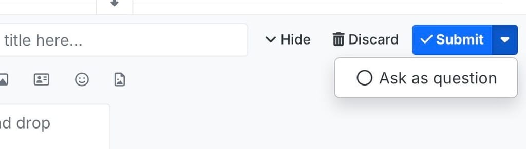

                    FYI I think you can mark this as „solved“ yourself.
                    Change the initial post to „Ask a question“
                    and then mark the correct answer as the solution.
                    • P p44 marked this topic as a question
