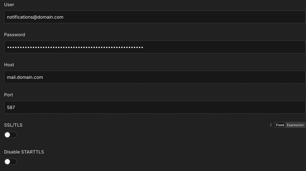

            Hello @overclockmp
            Could you please share a screenshot of your N8N configuration for SMTP?
            O 1 Reply Last reply

                  O Offline
                  O Offline
                  overclockmp
                  Hi @james, here is a redacted screenshot that should match my description at the beginning of this thread:
