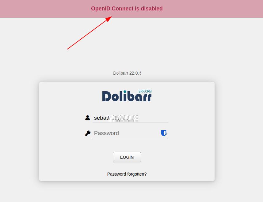

    Hello
    After importing my SQL backup, I'm unable to log in Dolibarr due to this error message ⬇
    OpenID Connect is disabled
    Is someone knows what I missed ?
    Thanks

              • sebastienserreS Online
                sebastienserre
                First command is returning an error
                root@069c78d3-05f5-4e4b-a0be-da6396c1f304:/app/code# /app/pkg/sync-users.sh
                ==> Syncing LDAP users into dolibarr
                Created directory: /var/lib/snmp/cert_indexes
                Error: Dolibarr config file content seems to be not correctly defined (file /core/lib/functions.lib.php not found).<br>
                Please run dolibarr setup by calling page <b>/install</b>.<br>
                then the second is producing PHP Warning and then never go out from recovery mode
                root@069c78d3-05f5-4e4b-a0be-da6396c1f304:/app/code# /app/pkg/start.sh
                ==> Ensure permissions
                ==> Starting Dolibarr
                PHP Warning:  Undefined property: stdClass::$MAIN_VERSION_LAST_INSTALL in /app/code/htdocs/install/get-version.php on line 33
                ==> Running upgrade hooks .  -> 22.0.4
                ==> Upgrading from version  to version 22.0.4
                [Wed Jan 14 07:48:32.022598 2026] [mpm_prefork:notice] [pid 22] AH00163: Apache/2.4.58 (Ubuntu) mod_perl/2.0.13 Perl/v5.38.2 configured -- resuming normal operations
                [Wed Jan 14 07:48:32.022648 2026] [core:notice] [pid 22] AH00094: Command line: '/usr/sbin/apache2 -D FOREGROUND'
                - - - [14/Jan/2026:07:48:40 +0000] "GET / HTTP/1.1" 200 7214 "-" "Mozilla (CloudronHealth)"
                The line - - - [14/Jan/2026:07:48:40 +0000] "GET / HTTP/1.1" 200 7214 "-" "Mozilla (CloudronHealth)"is repeating
