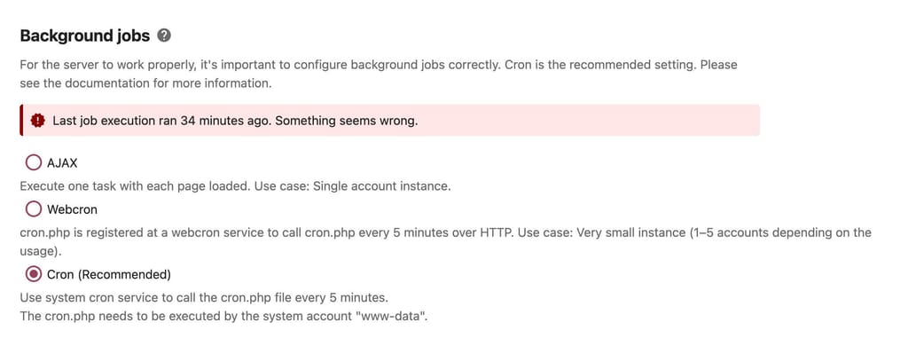

    Hello all, I hope you're all doing well.

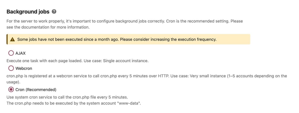

    My Nextcloud install cron isn't running. I only realised when my RSS feeds weren't updating. This has been the case for maybe a month, or longer.
    • If I reboot the app, cron runs successfully.

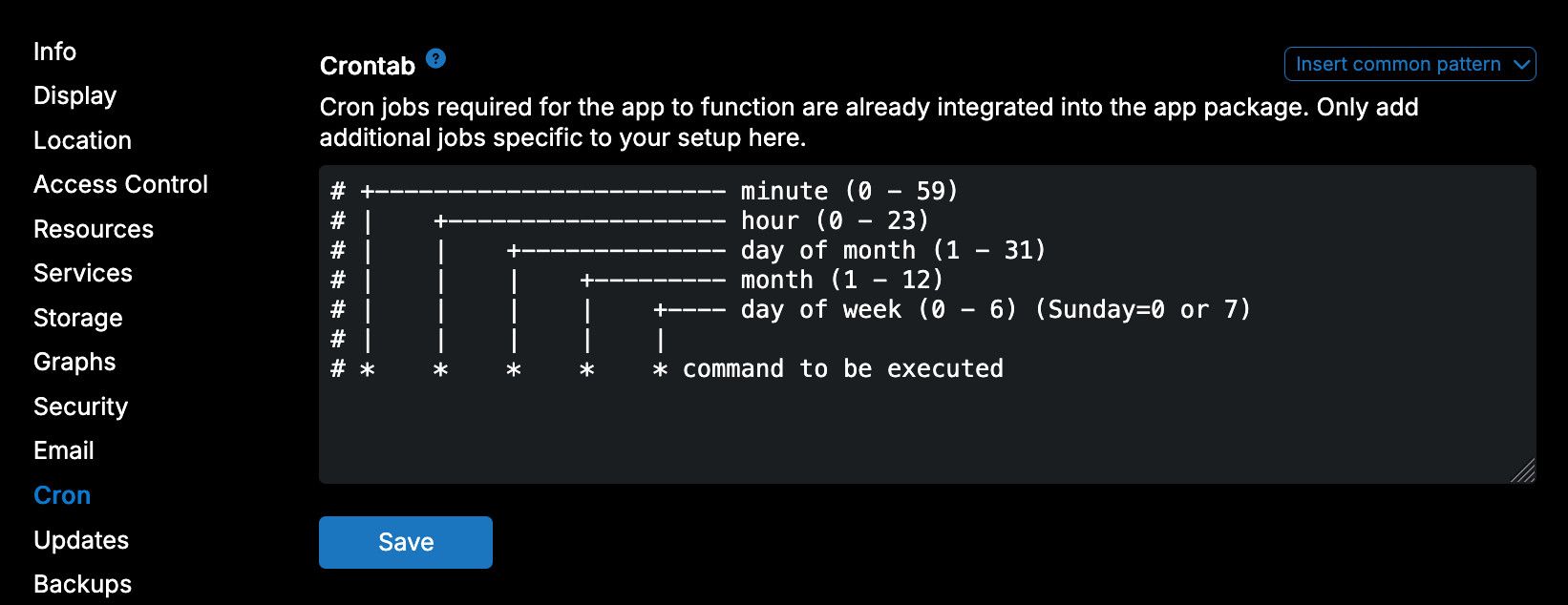

    • Looking in the Cloudron app UI, I don't see any entries in the Nextcloud app crontab:

    Reading more about an app's crontab being managed from the Cloudron UI - is it possible that that possibility was brought by a recent update, and it's not been configured? Just a thought.
      @ei8fdb so the warning does not go away even when you run the cron.sh manually?
      Nextcloud's cron is already in the package, there is no need to configure anything manually.

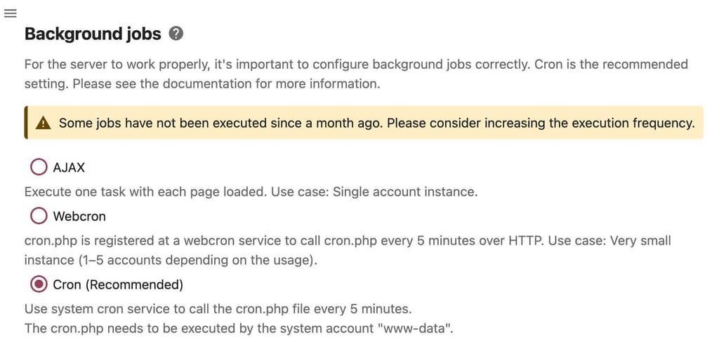

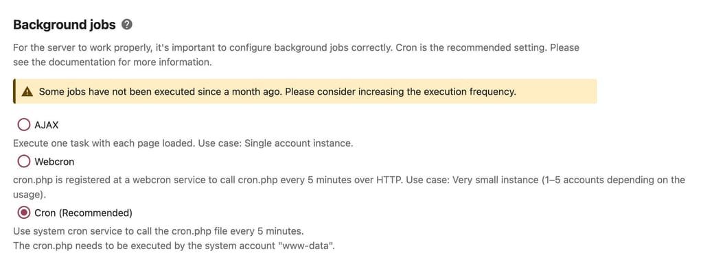

        • Here is a screenshot from the Nextcloud admin section this morning:
        • Immediately after taking that, I then ran /app/pkg/cron.sh manually from web-ui terminal. Here is the same Nextcloud admin UI but the warning message has changed:
        • After that (after about 30min due to meetings), I ran /app/pkg/preview-cleanup.sh manually from web-ui terminal, and here again is the same admin UI but with a different warning message:
        So, no the warning does not go away, the message text just changes.

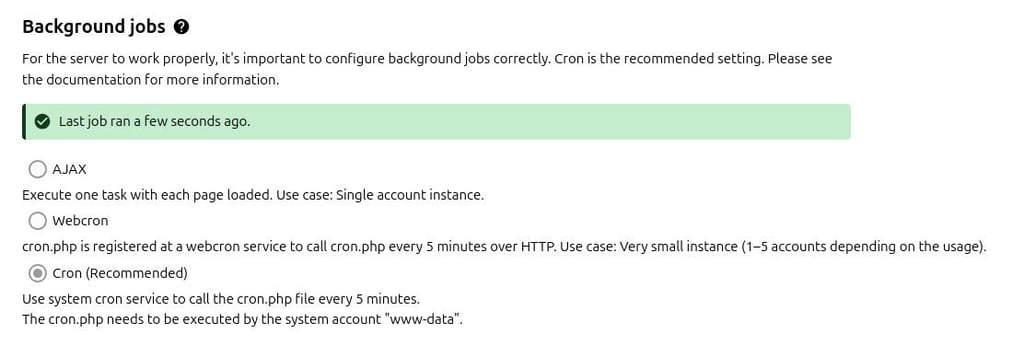

            • Some time after box restart - ~10m - the warning message changes automatically:
            • Some time after box restart - ~15m - it looked like cron ran

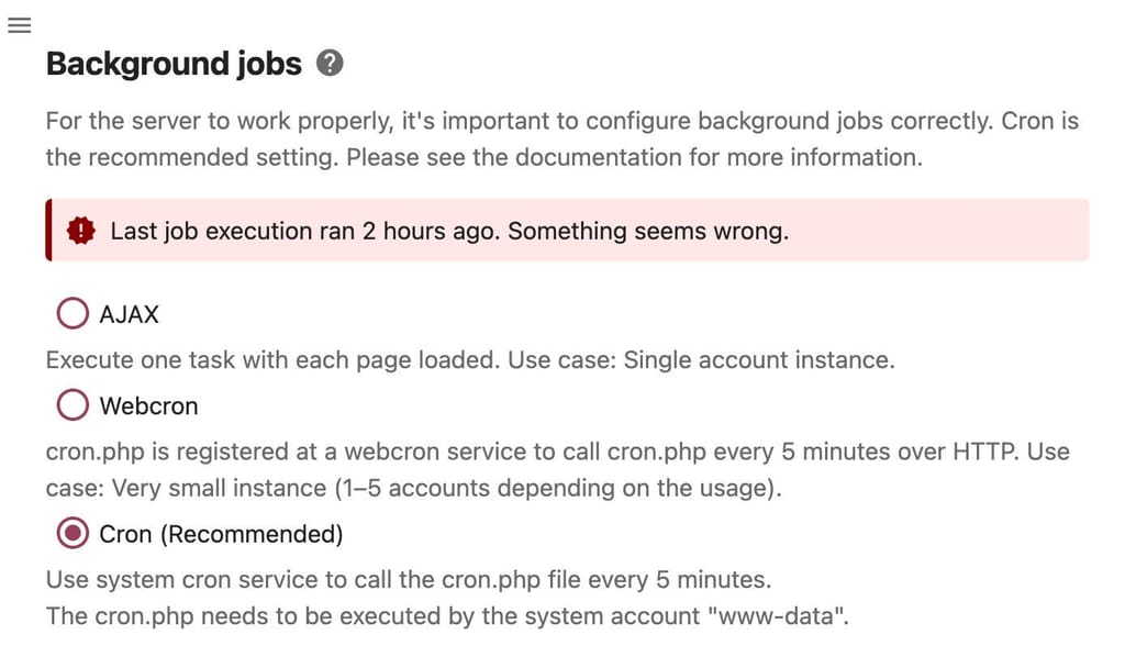

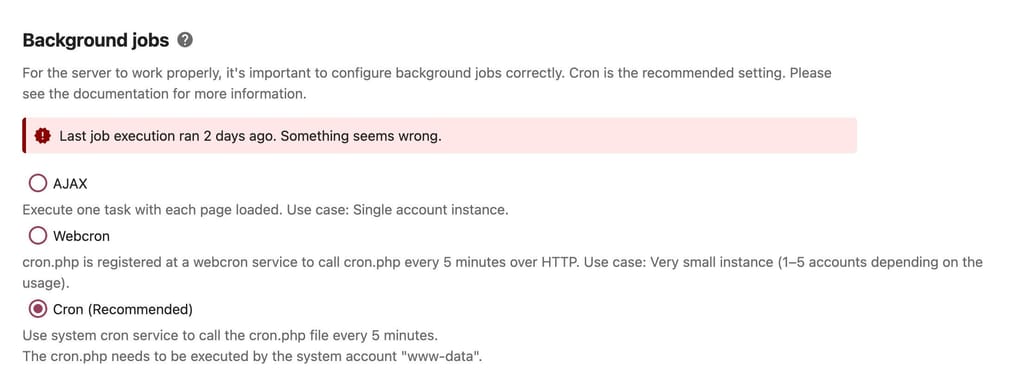

            • Since then, the admin UI looks like this:
            And I cannot see any mention of cron running since then.
            And I'm very confused. 😕
            I'm using the RSS feed reader app as a secondary indicator of cron running, no feeds have been updated since ~12:35:56.

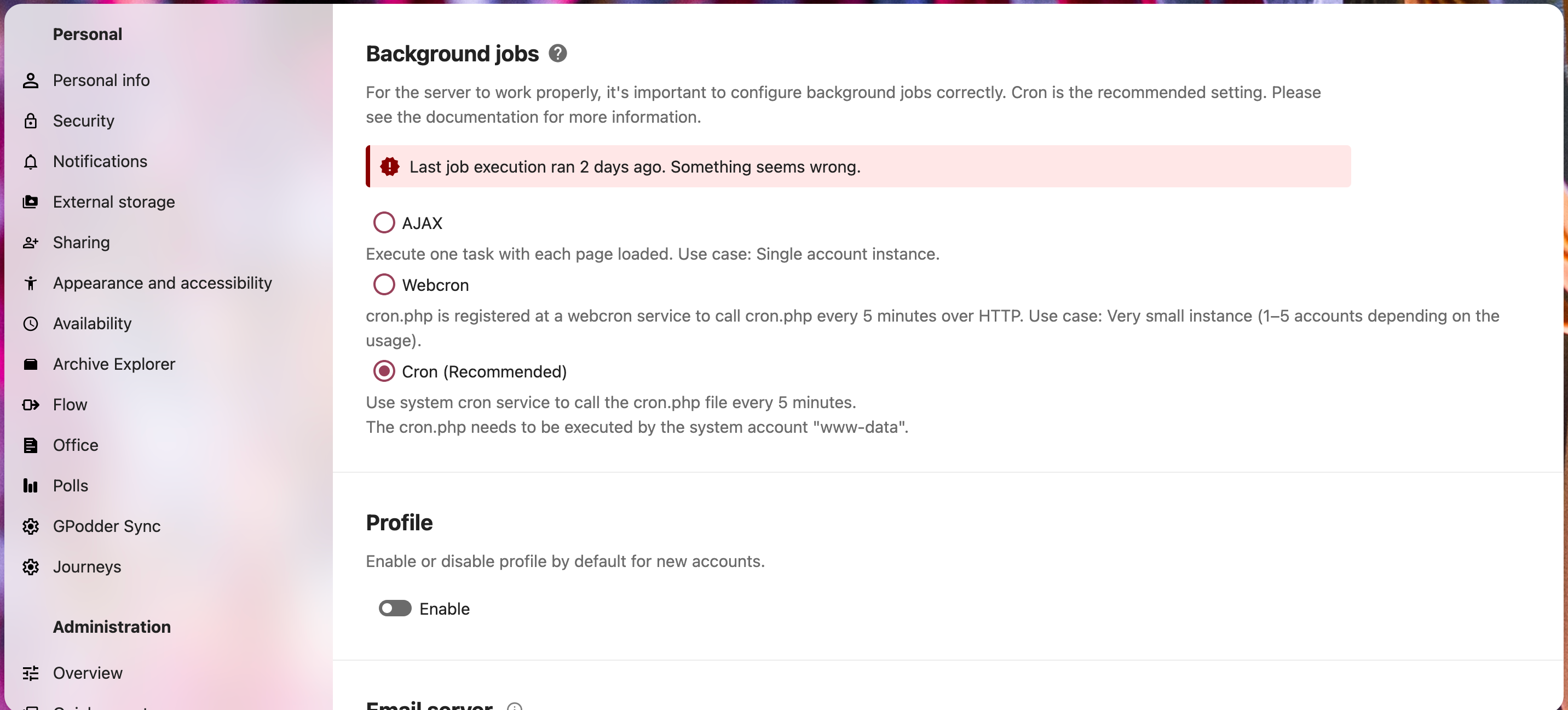

            • jdaviescoatesJ Online
              I have this:
              I don't think I've ever done anything to set it up.
              ei8fdbE 1 Reply Last reply
                I have this:

                  If you just add a custom cron job to run every minute for that app just echoing to stdout as used as an example at https://docs.cloudron.io/apps#cron
                  Then have the logsviewer open, do you see the echoed messages every minute or what your custom schedule is?
                    wrote last edited by joseph
                    There should be a periodic => Run cron job in your app logs . Do you see it? If not immediately, just keep the log window open for 20 mins, it will print every 5 mins.
