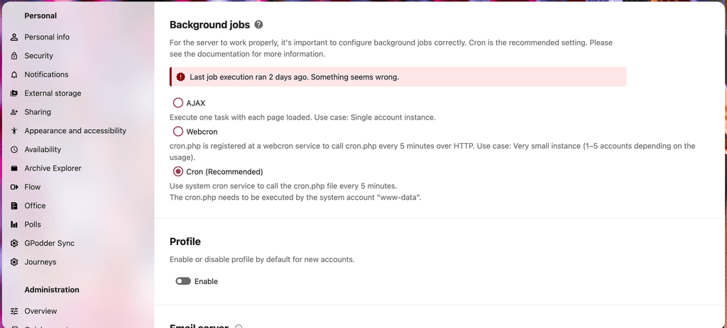

    My Nextcloud install cron isn't running. I only realised when my RSS feeds weren't updating. This has been the case for maybe a month, or longer.

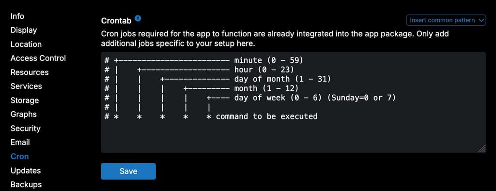

    • Looking in the Cloudron app UI, I don't see any entries in the Nextcloud app crontab:
    I can't find any other applicable forum posts.

    Reading more about an app's crontab being managed from the Cloudron UI - is it possible that that possibility was brought by a recent update, and it's not been configured? Just a thought.

        so the warning does not go away even when you run the cron.sh manually?
        No, the warning changes.
        Example:
        • Here is a screenshot from the Nextcloud admin section this morning:
        • Immediately after taking that, I then ran /app/pkg/cron.sh manually from web-ui terminal. Here is the same Nextcloud admin UI but the warning message has changed:
        • After that (after about 30min due to meetings), I ran /app/pkg/preview-cleanup.sh manually from web-ui terminal, and here again is the same admin UI but with a different warning message:
        So, no the warning does not go away, the message text just changes.
        I don't know where to look to fix this issue, so I'd appreciate guidance. Thanks.

                  Then have the logsviewer open, do you see the echoed messages every minute or what your custom schedule is?
                  • J
                    There should be a periodic => Run cron job in your app logs . Do you see it? If not immediately, just keep the log window open for 20 mins, it will print every 5 mins.
