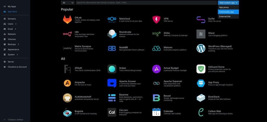

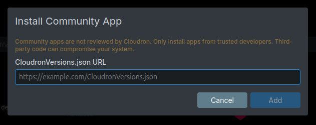

    Click on the Add custom app drop down top right in the App Store and choose Community app:
    Then paste in the CloudronVersions.json URL into the box that pops up:
