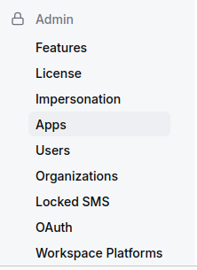

            @SystemFuchs said in Fix: no apps visible in com.cal.cloudronapp@1.16.3:
            You cannot add other apps through the web gui.
            You can if you first enable it from admin settings!
            I just tried adding the Nextcloud Talk app and a couple of others and it seems to have worked fine.
            First go to Settings bottom left:
            Then Apps:
            Then you can enable new apps.

                jdaviescoatesJ Online
                @ekevu123 said in Fix: no apps visible in com.cal.cloudronapp@1.16.3:
                I don't have Settings → Apps. In fact, there is no admin section after settings.
                You have to make an account an admin first because you can see the admin menu.
                I can't remember exactly how it was done, but note it must have a pw of at least 15 characters AND 2fa set-up, see https://forum.cloudron.io/topic/10288/cal-com-can-t-count/
                • E Offline
                  E Offline
                  ekevu123
                  You are right. You are forced to set up 2FA, then you log out and back in again, and only then the admin section appears under settings and you can enable/disable the apps.
                  Wow, I am impressed by who made that design decision.
