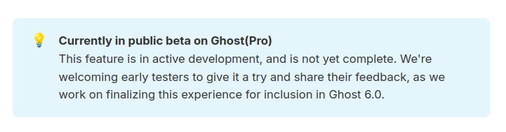

                      @bmann sounds like the intention is for it to ship with Ghost 6.0:
                      As shown at the top of https://ghost.org/help/social-web/
