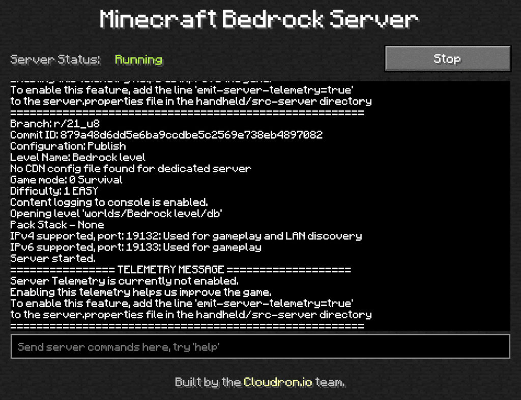

    MC Bedrock Server console shows:
    IPv4 supported, port: 19132: Used for gameplay and LAN discovery
    IPv6 supported, port: 19133: Used for gameplay
    Server started.

    As far as the server console and logs are concerned it looks like it is running:
    What am I missing here?
