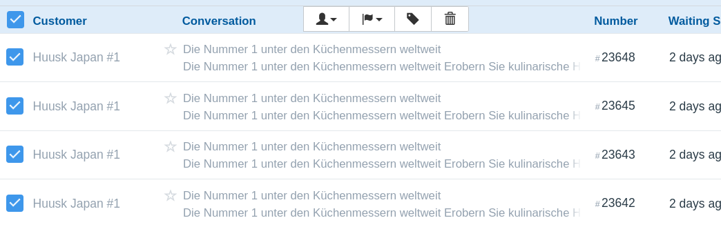

    For a few days now, I have been missing the trash icon in list views (as a normal user). As soon as I switch to a user with admin rights, the trash icon is there again. I have looked in the permission settings for users and mailboxes, but have not found an option to restore the trash icon (the “bulk delete” option) for normal users.
    Trash icon is only displayed for the admin role.

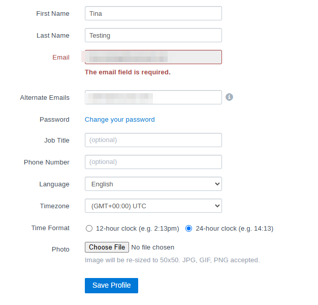

              Now as the new user, trying to add an Alternate Emails pressing save and getting the following critical notice:

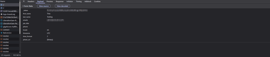

              When reviewing the POST request made there is only emails as a field send:
              The Email input field has the html id tag email The Alternate Emails has the html id tag emails.
              The html id tag email is missing the the POST request.
              The input field Emails can not be edited.
              Might not be related to the given issue, still is an issue.
