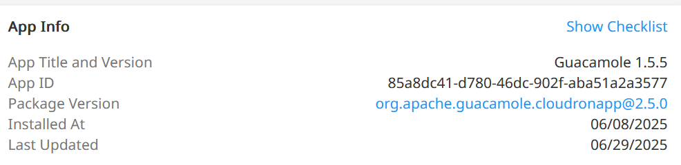

          @james are you able to check if you can reproduce this groups issue? The ticket I referenced states that this issue exists on 1.6.0 and that it works fine on 1.5.x , but on Cloudron we are running 1.5.5 .

                    Edit: I have confirmed via the Guacamole login page that I am running 1.6.0 which would align with the JIRA issue referenced. Not sure why Cloudron is showing 1.5.5. Might be a bug or something.

                        @hakunamatata good catch, the upstream version is incorrect in the package. fixing - https://git.cloudron.io/packages/guacamole-app/-/merge_requests/9
