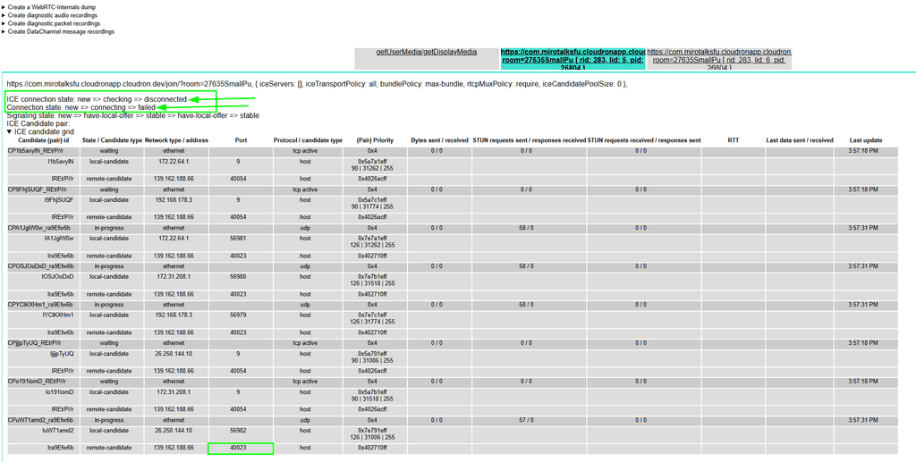

    I have two Mirotalks and both stopped working after upgrading past v2.2.22. I'm guessing some changes in this commit didn't work well on migrated instances. Participants can see other people join, but the loading circles never disappear, so no video and/or audio.
    However, copying the .env settings, installing a fresh Mirotalk and pasting those settings worked out in the end, but it's not great if the rolling updates crash existing instances.

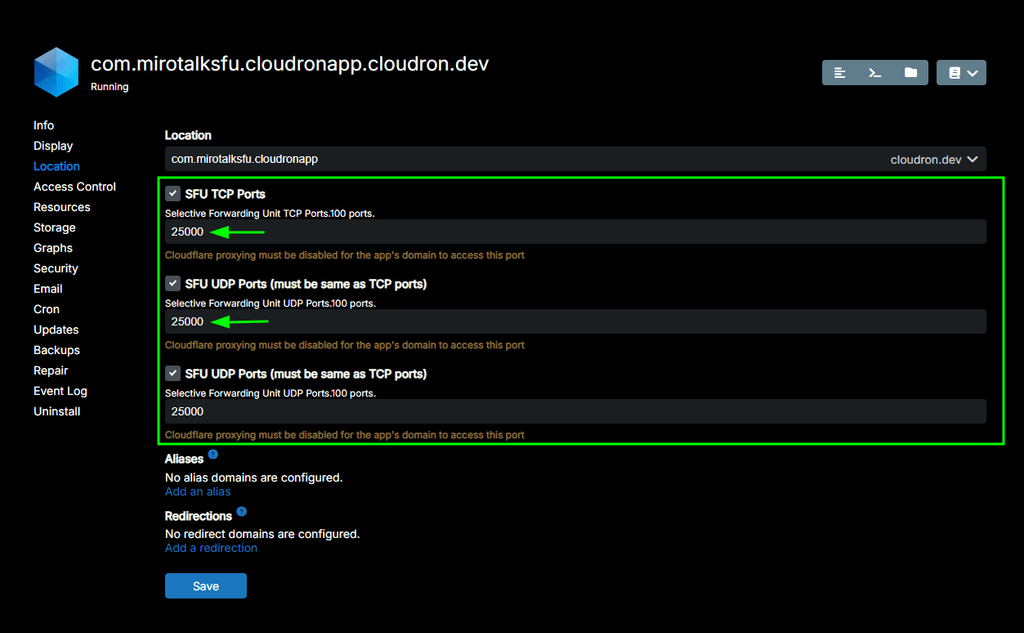

      Installing version 2.2.22 and upgrading to 2.3.1 not touching anything leads to a meeting where the feed is just loading endlessly.
      After changing the ports to 25000 in the location settings it worked again.
      I'm currently investigating why the old default of 40000 is now leading to issues.
      • jamesJ Online
        jamesJ Online
        wrote last edited by james
        TL;DR
        Changing the port from 40000 to 25000 in the location view after the update to 2.3.1 fixes this issue.

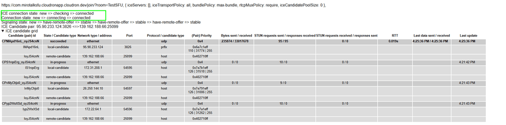

        It seems with the new defaults of 25000 the old settings of 40000 is now causing ICE connection failures.
        This can be viewed, when using Chromium with chrome://webrtc-internals and with Firefox about:webrtc.
        Chromium view:
        I can see the packages arriving on the Linux system with tcpdump portrange 40000-401000-i eth0 and udp and tcpdump portrange 25000-25100 and udp -i br-e1aa4ec2a833
        After changing the port to 25000 in version 2.3.1 I can see my desktop and mobile device in the tcpdump and the ICE connection is successful for the ICE channel for audio and video.
        eth0 interface:
