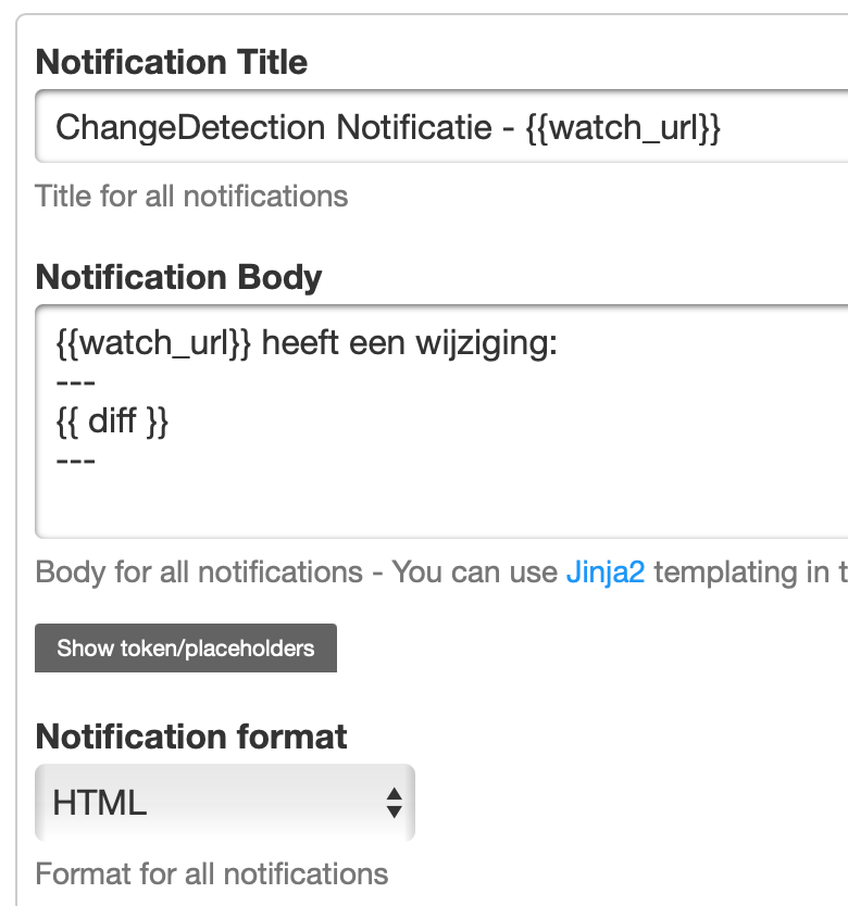

                imc67
                In the Cloudron app the output in the email is:
                https://changedetection.io/time.php heeft een wijziging: --- @changed_PLACEMARKER_OPEN1762182459.6731@changed_PLACEMARKER_CLOSED @changed_into_PLACEMARKER_OPEN1762182761.7355@changed_into_PLACEMARKER_CLOSED ---

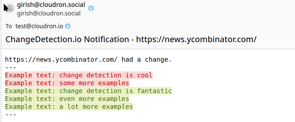

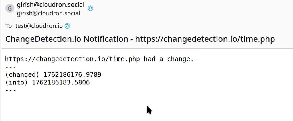

                        @imc67 Did I understand correctly that I should send a test email and this will reproduce the bug?
                        Works for me.. but still playing around. It seems the new default format is HTML Color but in your github issue it is HTML. That doesn't seem to matter though.
                        imc67I 1 Reply Last reply

                          steps to reproduce:
                          1. create a watcher on https://changedetection.io/time.php
                          2. set it to Chrome and settings like this:
                          3. set it to check for every 5 minutes
                          4. notification method: email via mailtos://user:pw@domain.xx?smtp=mail.domain.xx&user=x@x.xx

                              @imc67 that works for me as well.
                              I think it's probably related to some migration logic from older version. I am trying a Change Detection from 2-3 weeks ago and see if it's reproducible .
