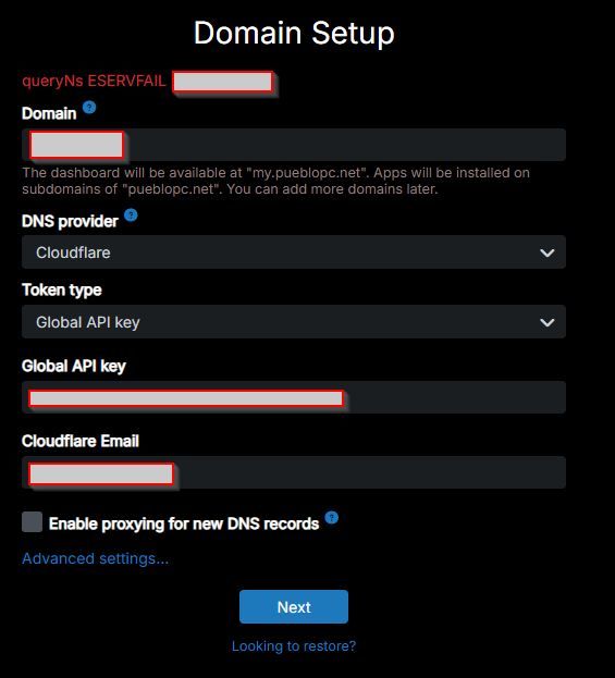

    Hello all, I have a new server VM spun up, Ubuntu. I have installed cloudron, can access the setup page via domain name without issue. when hitting the initial setup page I enter the required information, then get the queryNs ESERVFAIL domainname error. hitting the domain externally or internally prodices the same error, which leads me to a server issue. I run the troubleshoot command with the result below. I have gone as far as deleting the VM and creating a fresh install which produces the same error. Can anyone help me diagnose my issue?
    Thank you and happy holidays!

        Thank you for your reply. I have setup a new VM with ubuntu 24.04. same issue occurs. I can visit the initial setup screen, then get the serverfail error, both by visiting the domain name and the IP of the server locally.
