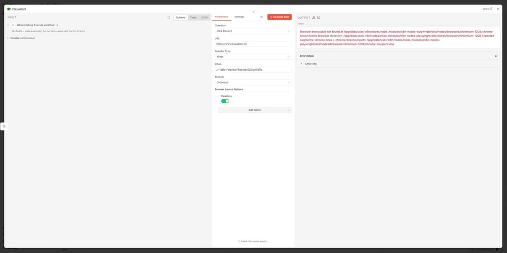

How to use Playwright in n8n?
Hello @odie
The best way to install community nodes for N8N is with the UI.
In your case you want to install https://www.npmjs.com/package/n8n-nodes-playwright I assume
In your N8N UI go toSettings>Community nodesclickInstall a community nodeand pasten8n-nodes-playwrightand it will install the community node.But while testing this I noticed that the Cloudron N8N app does not have chromium installed, so the playwright nodes can't be used at the moment.
So we might have to add chromium to the N8N app.

@james Thank you @james! I was under the (wrong) impression that it was already installed (due to it being listed in /app/code/node_modules, thank you so much for clarifying.

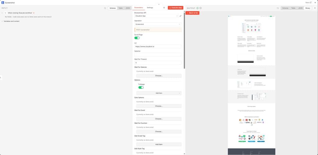

We have discussed adding chrome or similar to the N8N app and decided against it since it would increase the maintenance scope.Instead, we have packaged Browserless as a Cloudron app that can be used be other apps as well.
For example, N8N can use the https://github.com/minhlucvan/n8n-nodes-browserless community node to connect to the Cloudron Browserless app.
The Browserless app is currently only a community app located here https://git.cloudron.io/playground/browserless-cloudron-app and can be installed with the CloudronVersions.json.
We plan to move this to the Cloudron appstore tho.
