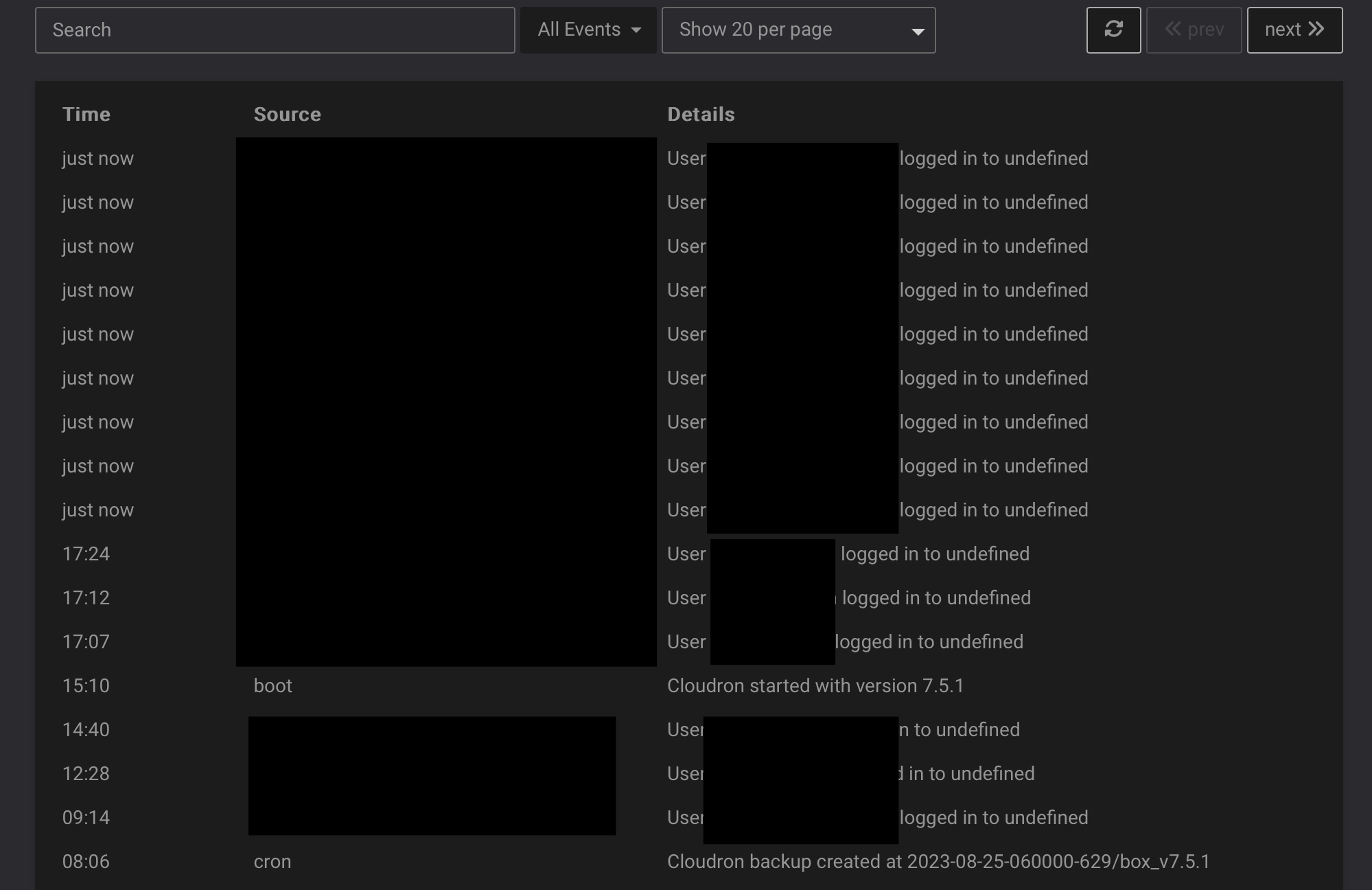

    Yesterday evening I updated one of my Cloudrons from 7.5 to 7.5.1. All looked ok.
    I just was reviewing the Event Log (see screenshot) and noticed two strange things:
    1. in the details line it says "logged in to undefined" where before the corresponding app or service was noted
    2. today at 15:10h it seems that Cloudron was suddenly restarted?!?!
      @girish was already working on the undefined display issue. This comes up with the move to OpenID instead of LDAP. Will be fixed with next release.
      For the Cloudron started event, maybe just the box service restarted? You can check on the server with journalctl --list-boots over SSH when actual system reboots happened.

        @nebulon said in 7.5.1 bug in event logs and unexpected boot:
        This is the result but the date/time is totally different and I'm not aware of a system reboot:

          @imc67 the boot is referring to the box code starting and not to the system booting. Can you check if there is a crash in the logs around the time the event was raised?
