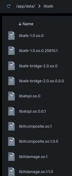

        @BrutalBirdie - thanks, but these are Node modules and not OS modules. Luckily, I did find a workaround. Step by step, I found all the missing modules, downloaded the deb files from https://packages.debian.org/, then extracted them into = /app/data/libatk/ (because that was the first missing library)
        After this, I discovered the entrypoint script calls an editable script and edited /app/data/env.sh with these lines:
        export PATH="/app/data/libatk:$PATH"
        export LD_LIBRARY_PATH="/app/data/libatk"
        Once I did this, I was able to enable Add Container Arguments on the Puppeteer nodes options in n8n and it worked just fine. The "container arguments" has it ignore all sandboxing best practices (which is OK since we're running in a container).
