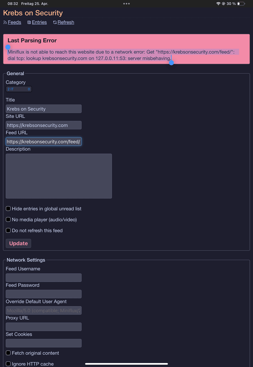

    Many (not all) feeds that I know exist are not fetched with this error:
    Miniflux is not able to reach this website due to a network error: Get "https://krebsonsecurity.com/feed/": dial tcp: lookup krebsonsecurity.com on 127.0.0.11:53: server misbehaving.
    Googling this error led to nothing.

                        Hard to say, but I don't know what those LIBVIRT_ chains are for, but they do seem to touch on port 53 at least, so possibly those causing a problem. Do you know where those chains might come from?
                        • necrevistonnezrN Offline
                          Thanks for the hint! It reminded me that I had tried something with qemu-kvm a while ago. After removing those rules, everything seems to be working!
                          • necrevistonnezrN necrevistonnezr marked this topic as a question on
                          • necrevistonnezrN necrevistonnezr has marked this topic as solved on
                            No, the errors came back. Is it at all possible it‘s connected to Adguard Home running on the same Cloudron (which uses port 53, IIRC)?
                            My /etc/resolv.conf looks like this btw
                            nameserver 127.0.0.53
                            options edns0 trust-ad
                            search fritz.box
                            My iptables look fine now…
