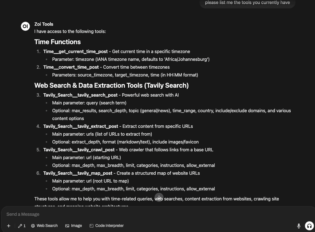

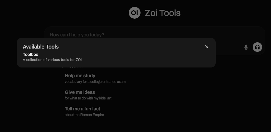

                      D Offline
                      Divemasterza
                      You can use https://github.com/metatool-ai/metamcp
                      it's an orchestrator for MCPs and very easy setup.
                      bonus - all the mcps can be bundled in one endpoint
                      and then for the example here I have Tavily and Time MCPs
                      firmansiF 1 Reply Last reply
