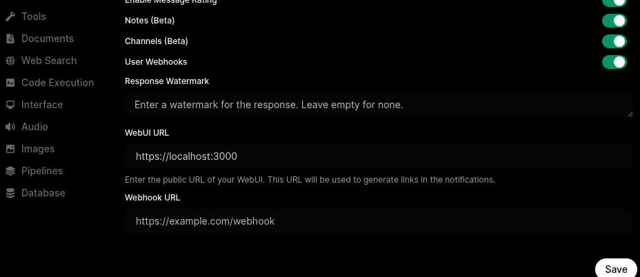

                              @Package-Updates Recent update the OIDC redirection still has issue which points to localhost port 3000 instead of existing domain used for the OpenWebui instance. Eventhough the service start is already normal

                                  @canadaduane The solution that I take to this is you log in as Admin credential, and then go to Admin Panel and enter your domain in the Web UI URL at the bottom of page

                                    The latest package should now do it by default on every app restart.

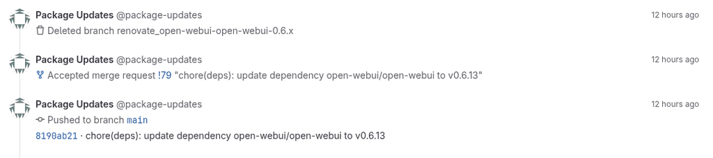

                                      @james I've seen the latest version 0.6.13 is on process in cloudron git, hopefully works well, the previous version 0.6.12 has several issues especially with OpenAI and Google Gemini, and that's why they release next version to fix the few important bugs in 0.6.12
                                      • firmansiF firmansi
                                        #28
                                        @firmansi sorry but I don't understand what version you are speaking of.
                                        The latest OpenWebUI Cloudron Package has the version tag 2.14.6 and this packages OpenWebUI 0.7.1
                                        firmansiF 1 Reply Last reply
                                          firmansiF Offline
                                          firmansiF Offline
                                          firmansi
                                          #29
                                          @james I see this in repository
