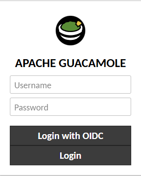

    I have 2 Cloudron instances which are synced with on-premise AD servers. I have the Guacamole app installed with the location set to use the bare domain. Prior to Guacamole V2.0 package update, users would browse to the Cloudron domain, login with their AD credentials at the login page shown, and were taken straight to Guacamole. From V2.0 package update onwards, the new OIDC login feature requires users to click a tiny link in the bottom corner of the initial login page, which takes them to another login page (OpenID Login page), to then log in with their AD credentials. (To clarify for those that aren't aware, using AD credentials at the first login page no longer works).
    Not sure if I am missing something - but is it possible to set the default login page for Guacamole as the OpenID login page? Or is it possible to set the default login page to use the OpenID credentials? I've had a look through the GUI settings, checked the forums and google, but come up empty. Any help is appreciated.
      Hello @phsc
      Unfortunately I am not aware of a simple way to make OIDC login as the default.
      Maybe you could create a custom branding and change the login page HTML to reflect what you would like to have.
      To have something like this:
      I just edited the HTML in the browser as a mockup.
      See => https://docs.cloudron.io/packages/guacamole/#branding

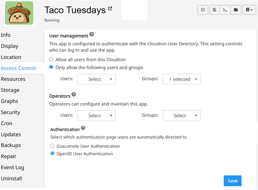

                Hi @james, yes, I think so. Correct me if I am wrong, but Guacamole is configured to use Cloudron's OIDC Provider, so it makes sense that it would automatically take you to the OpenID login page. If you wanted to give less technically able users (like me) a choice, I'm assuming an option could be put under the Access Control section of the Guacamole app settings?
