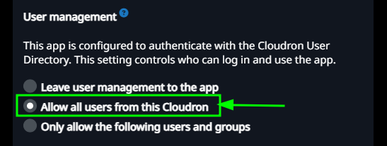

      Hello @kmz010101
      Did you install the app with the following option?
      If so, OIDC will always be used even with that configuration.
      If you truly wish to use this config you need to install with the Leave user management to the app option at installation.
        Hello @kmz010101

        • K Offline
          K Offline
          kmz010101
          Thanks for the tips, but oidc is already diabled in the env. Perhaps I will try to reinstall it with the other User settings. The strange thing is it worked bevore they changed it to env deployment

              kmz010101
              I tried it but it didn't work. I set up a ne instance und selected user management by the app. And now it works with the new instance.
              MiroTalkM 1 Reply Last reply
              • K kmz010101
