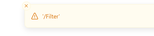

    I'm running OpenWebUI as a Cloudron app and encountering two persistent errors when uploading PDF files:
    When I upload a PDF, I sometimes get this error:
    [Errno 30] Read-only file system: '/app/backend'
    This happens when OpenWebUI tries to extract content from a PDF (likely to create an embedding or perform OCR).
    In other cases, I get:
    '/Filter'
    — which looks like an error related to PDF parsing (possibly missing a filter handler or a corrupted stream).

    Request:
    Could you please:
    Confirm what directory OpenWebUI expects to use for writing temporary files or extracted text?
    Suggest how to reconfigure the app or container to allow write access in Cloudron (e.g. by changing the temp directory)?
    Help clarify what the '/Filter' error actually means in the context of PDF handling?
    Thanks a lot!
