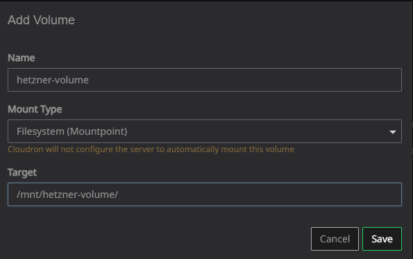

      There is a difference between Cloudron Volumes and Hetzner Volumes.
      In the guide is written:
      Do not use a Cloudron Volume as storage location for the directories below. Set up fstab or systemd mount manually.

      That what Cloudron Volumes are for.

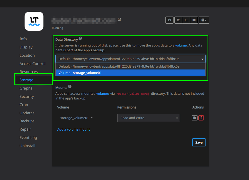

      You can add a Hetzner Volume and mount it to e.g /mnt/hetzner-volume/ and then in the Cloudron Dashboard at volumes do the following:
      Then, for each app you can move the data directory.
      Like it is described in the doc https://docs.cloudron.io/apps/#data-directory and https://docs.cloudron.io/volumes
