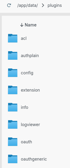

            I can't confirm it is activated because I can't log into the system. But that plugin is in the filesystem:
            I also have this in my conf/local.php file: $conf['plugin']['oauthgeneric']['scopes'] = array();
            I don't know, might need to just reinstall.
