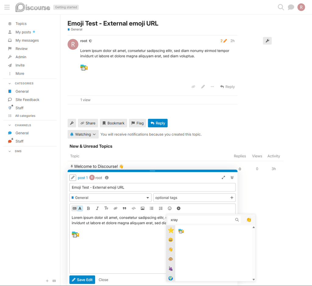

                  Once done the steps above, I thought that it is all set. Now, I discovered that there are many more emoji present in quick access at least inside the chat interface. @staff would it be possible to move the app/code/public/images/emoji/ into app/data/.../emoji so that one could remove entire emoji sets or to make customization at the source please ? 🙏
                    Hello @mononym
                    I have looked into this feature request for the @discourse app.
                    Unfortunately just tinkering with the emoji files directly does not work as flawlessly as thought.
                    This will result in broken images, wrong displayed emojis and even @discourse crashing when starting the app.
                    A fully custom emoji set in @discourse can only be achieved with a custom plugin.
                    An example would be: https://github.com/cpradio/discourse-plugin-vb-emoticons
                    Which then can be configured to be used in the @discourse Emoji settings.
                    But there is a somewhat silver lining.
                    Discourse offers the configuration option to set a custom emoji URL.
                    With that you can specify a URL that holds custom emoji images.
                    The external URL folder structure and file names must follow a template: https://github.com/discourse/discourse-emojis/tree/main/dist/emoji emoji set and must include all emoji image files. Otherwise, they will get displayed as broken images in the post and emoji picker.
                    You can download these folders and files and upload them to e.g. a @lamp app.
                    I have done so and placed the folders in /app/data/public/images/emoji
                    In @discourse I have configured the setting External emoji URL to https://lamp.cloudron.dev/images/emoji and I have set the Emoji Set to Noto Emoji.
                    In the @lamp app I have replaced the xray.png and x_ray.png in the noto folder with a custom PNG, but the file name must be xray.png and x_ray.png to replace the xray emoji.
                    Which then gets displayed correctly in the post and the emoji picker:
