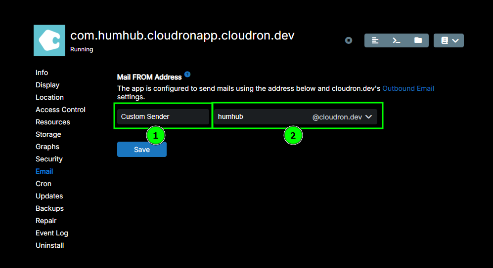

        In the Email entry in the Cloudron dashboard of your Humhub app, you can change the From Name (1) and the Mailbox Name (2).

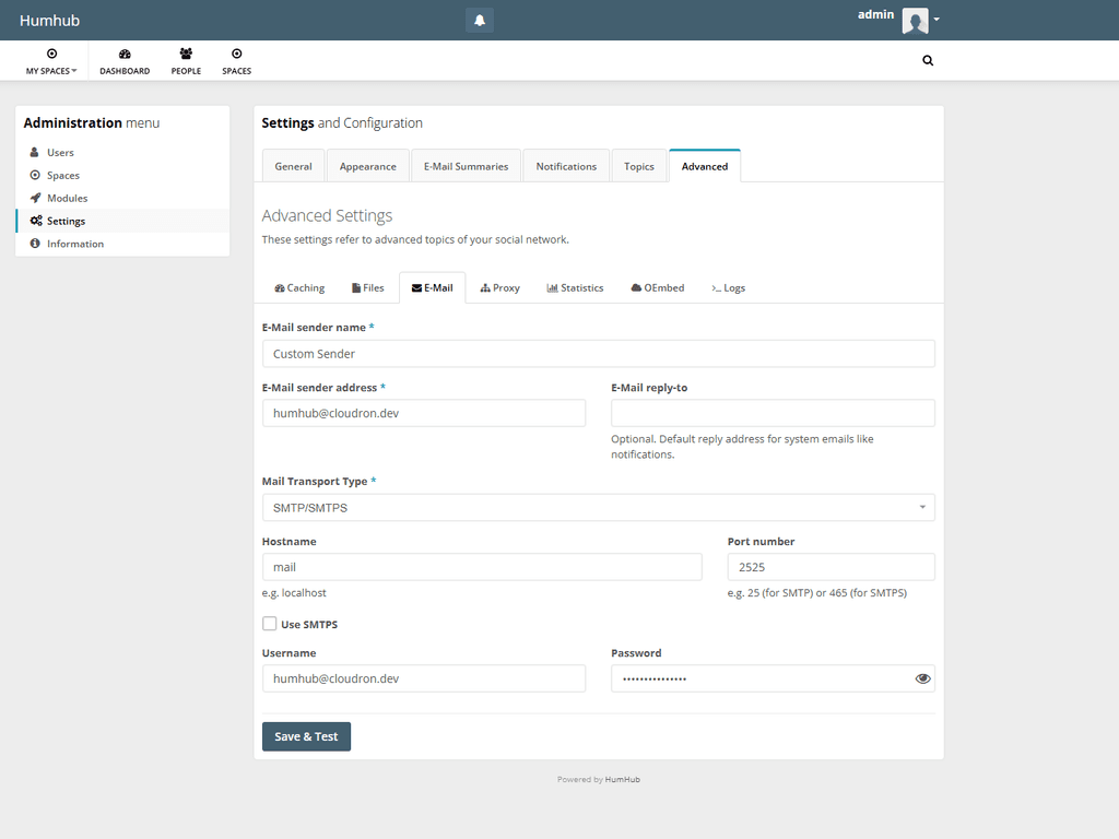

        When you make changes there and press save, this will be configured automatically and can be checked in /admin/setting/mailing-server

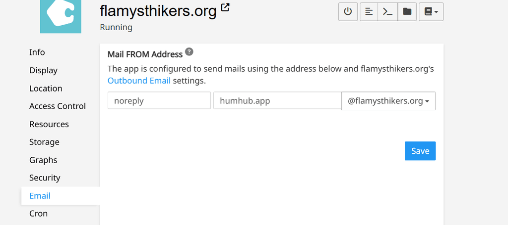

          No you understand, but either I am doing it wrong or it isn't working. I tried changing one (above image) to noreply and delete the humhub.app. The domain is set to my domain name. It didn't work. I tried just changing the humhub.app, it didn't work. I tried leaving the noreply and humhub.app and it didn't work. The only setup that works is humhub.app with my domain name. (I never change the domain part)
          • D dffla

              You attached an image with the number 1 and 2 above. See the screenshot below. It is not working with the noreply.

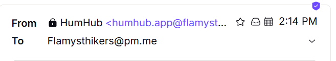

                This is how the notification email looks. See screenshot.

                  If you want the outbound address to be noreply@domain.tld then you need to put the noreply in the second box. The first box is for the sender name. If you put noreply in the first box and left the second box blank, then when you saved it the default sender humhub.app will have been set.
                  • D Offline
                    D Offline
                    dffla
                    That worked! Thank you so much!!!
