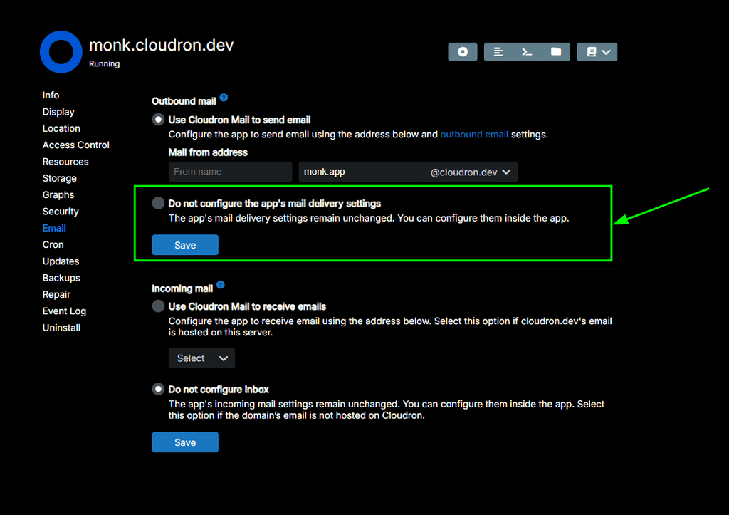

      Hello @OneTools-Project
      By default Cloudron will always configure the app.
      You will have to disable the configuration the the Cloudron Dashboard of the Listmonk app:
      after selecting this, the SMTP setting will no longer be changed.

        Thanks a lot.
        It works!
