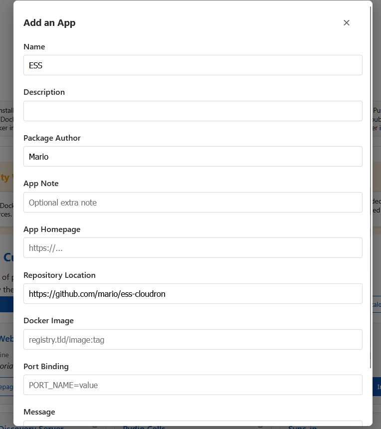

                      @mario I'm trying to install ESS via CCAI. Can you please let me know what the proper values are? TIA!
                      marioM 1 Reply Last reply

                          mario
                          @humptydumpty I'm not familiar with CCAI. You shouldn't have to enter ports etc at all as those are defined in the Manifest that's in the repository.
