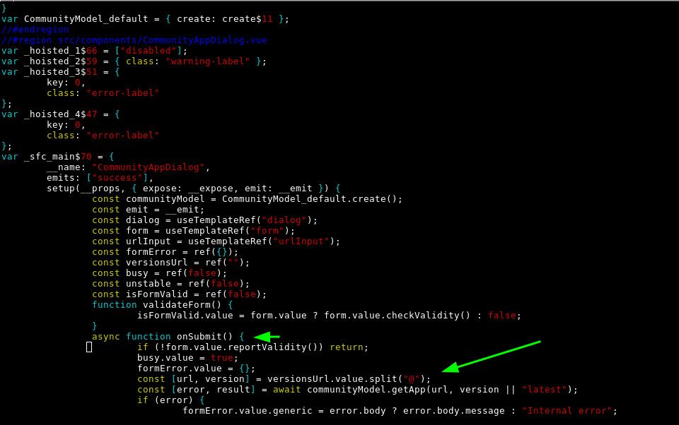

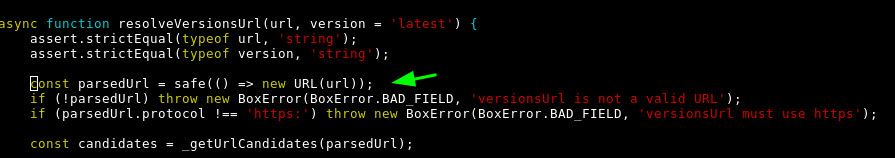

                              H Offline
                              H Offline
                              huehner
                              Hello @james. I tried that before and it fails with the error message i mentioned "versionUrl is not a valid URL".
                              Trying to explain a bit better what i mean
                              Problem seems to be that this line in your frontend code
                              const [url, version] = versionsUrl.value.split("@");
                              For URL entered in the Cloudron Admin UI of value https://user:password@domain/path
                              The http-request send by the Admin-UI is
                              /api/v1/community/app?access_token=<redacted>&url=https://user:password&version=domain/path
                              which can be seen in Browser Developer tools.
                              As the frontend code seems use the @ character for its own purpose.
                              I'm not sure what it is trying to do as in the Publishing documentation there's no information about an @ symbol or some version value in the URL.
                              With gitlab.cloudron.io not accessible i can't share code link what i talk about for 'split' by @ is this code here
                              My guess is that this then too short url from that split reaches the backend here: box/src/community.js
                              and then is no longer a valid URL.
                              That is just a theory i might be totally wrong (and i don't have a test system i can add some debugging right now)
                              J jamesJ girishG 3 Replies Last reply
                                it is git.cloudron.io
                                    @huehner a workaround for now is to use ?username=xx&password=yy . I have fixed the issue that you reported in any case and it will be part of the next release. With the fix you can pass username:password in the URL .
