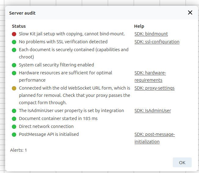

    I'm a user/admin who is getting frustrated by frequent "Document loading failed" errors. I tried to work out what was going on, with the help of an LLM, and it concluded that there was nothing I could do personally. Happy to provide more info if there's anything I can provide.
    Here's a bug report that the LLM drafted. Exercise cynicism.
    ⚠️ Authorship note: This report was drafted by a large language model (AI assistant) from server logs, browser-console output, and a debugging session. The log excerpts, config excerpts, and command outputs below are from the real system and are believed accurate; the root-cause analysis and proposed patch are LLM inferences and have not been confirmed by a human expert. Please verify before acting. The human reporter is a non-expert and can supply full logs and run further diagnostics on request.
    Summary
    On a Cloudron instance, opening office documents from Nextcloud intermittently fails with "Document loading failed / Failed to load Nextcloud Office (Collabora)". The failure is transient: retrying often works, and sometimes the document appears after a short wait without any page reload.
    Root cause (as analysed): the Collabora app container ships a correct nginx config in /etc/nginx/snippets/coolwsd.conf, but the active /etc/nginx/nginx.conf does not include it. The active config has a WebSocket-upgrade location only for the legacy URL form /cool/<encoded-wopisrc>/ws. Collabora 26.04's new compact WebSocket URL /cool/ws?WOPISrc=… does not match it, falls through to a generic location ~ ^/(c|l)ool that does not set the upgrade headers, and coolwsd rejects it with HTTP 400 Invalid or unknown request. The client then intermittently falls back to the legacy URL, which is upgraded — which is why loading is flaky and self-heals.

    Collabora 26.04 introduced a compact WebSocket URL /cool/ws?WOPISrc=…, replacing the older path-embedded form /cool/<encoded-wopisrc>/ws. Reverse proxies that only recognise the legacy form fail to upgrade the new URL. This is a documented upstream change requiring proxy-config updates:
    • Upstream fix: Collabora Gerrit change 4102 — "Apache proxy: tunnel the compact /cool/ws WebSocket URL" (merged 2026-06-09), which adds ProxyPass /cool/ws ws://127.0.0.1:9980/cool/ws nocanon alongside the legacy rule: https://gerrit.collaboraoffice.com/c/online/+/4102
    • Known issue: CollaboraOnline/online #15918 — "Websocket connection fails on Version 26 and newer" (Invalid or unknown request after upgrading to collabora/code:26.04.x): https://github.com/CollaboraOnline/online/issues/15918
    • Proxy docs referenced by Collabora: https://sdk.collaboraonline.com/docs/installation/Proxy_settings.html

          Hello @da5nsy
          An app update will be available soon that will fix this issue.
