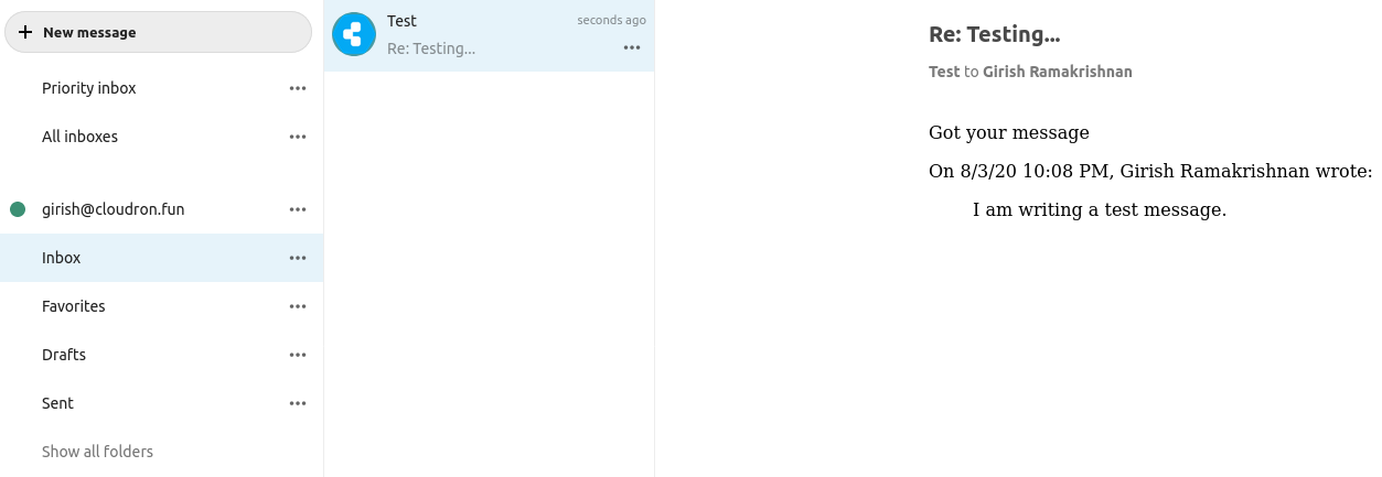

      @Bortseb There are atleast two mail clients on nextcloud. The docs is describing the setup of Rainloop app in nextcloud. Looks like you are using Mail app. I have fixed the docs now to show settings of this Mail app as well - https://cloudron.io/documentation/apps/nextcloud/#mail-app
      About the error itself, if you open the browser console, it gives a better description like:
      After that, I was able to send/recieve mail:

            Thanks @girish that worked! Seems the only thing I did different was turning off STARTTLS in the SMTP section.
            and also thank you @marcusquinn for letting me know all the other options that are better. At this stage I'm just sort of playing around and testing things out to try and get them to work, and seeing how they work.
