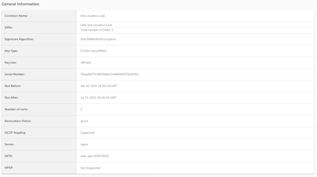

        Reading up on this... One thing led to another and I ended up implementing it πŸ™‚ Should be in next release. Currently, it's enabled for all new certs. I will let it sit for a while to check if causes any issues with various browsers.
        Firefox now shows that the cert has OCSP must-staple:
        The connection also has the staple information:
        Also, verified with openssl s_client -connect hostname:443 -status:

          The change is pretty small, if anyone is interested - https://git.cloudron.io/cloudron/box/-/commit/4d919127a73717d43f14e0d90ba2dc46785c16c8 .
            Grr, I knew it was too good to be such a simple change. I found that the first visit on firefox (unlike chrome which ignores must-staple) always fails. Investigating, it turns out, nginx does not fetch OCSP responses on reload or restart - https://trac.nginx.org/nginx/ticket/812 . So, one has to prime the OCSP cache using curl requests. Alternately, one can use openssl ocsp -noverify -no_nonce and then ssl_stapling_file. Both approaches won't work if the OCSP servers are down and then we have to have some retry logic. Also, the cache is per nginx worker, so I have no clue how many times one has to call curl. The ssl_stapling_file approach requires some refresh logic as well πŸ€•
            So, I have changed the code to not enable must-staple in the certificate request. It minimizes the security benefits but we have to wait on nginx to make this properly work.
