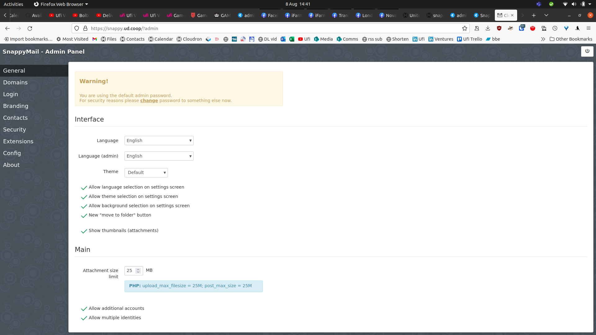

      Ah, I think that file gets created on the restarted after enabling allow_admin_panel = On
      I had manually created and written a pw just before the restart, but that didn't work because the restart generated the pw and inserted it into that file.
      But now I'm in:
