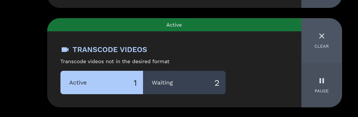

    Since my videos wouldn't play in the browser, I tried different video encoding settings. Long story short: each value generates the same error in the logs:
    ERROR [MediaService] Error: ffmpeg exited with code 1: Unrecognized option 'fps_mode".`
    I didn't find anything in the immich issue queue. Do you think it is a bug in the app package?
    The way to go:
    for my tests, i switched the transcode policy to all videos (admin -> settings -> ffmpeg settings
    admin -> settings -> Jobs -> TRANSCODE VIDEOS press All
    Switch to Cloudron -> App -> Logfiles
